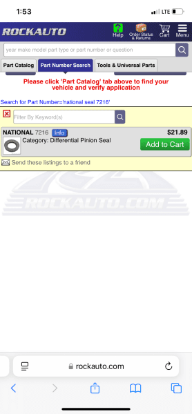

Guy has 6 left 1828719, a little pricey at $37.50 shipped plus sales tax.
[/URL][/URL]
Yeah, A little pricey but considering another guy in Missouri wants $55.00 plus $11.00 shipping for the same one and the National one I got from Oreilly's was $33.75, it probably is reasonable. The one I got from Dr Diff. was $10.00 plus $18.00 shipping.

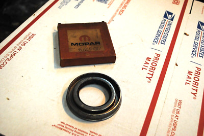

With it all said and done, I'm kinda wishing I would have just got the leather factory Mopar one. It lasted over 50 years before starting to drip.
The problem I ran into was there are two rubber seals out there and the leather. Mostly you'll get the rubber single groove one. Cass (Dr. Diff) sells the double seal one. The leather one I tried would leak. The one I got from Cass is doing well.
