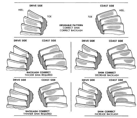

Maybe something as simple as this can help in the future..............

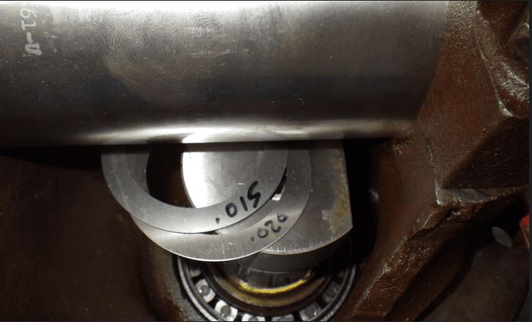

I scored this installation kit some time ago cheap. Occasionally they show up on Ebay.....

by up you mean towards the crown? There is maybe 1/16th of a inch or less left there.. with the .072 it was almost nothing..
Towards the heel.

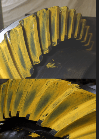

Soo.. between not being able to get a pattern that looks like a pattern, and tonight i set it up for the final time and i set backlash at .008, on a whim decided to check different spots and found anywhere from .008 to .013... these gears are just a mess.. i think i'm just gonna replace them. (hope it's the gears causing the runout... Wasted 2 weeks on this.

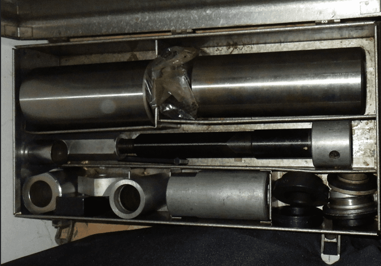

BTW, i bought a clamshell bearing puller and man that thing is worth every penny, although i'm glad i saw a video where you put a spare race over the bearing so it doesn't hurt the cage when pulling... I then honed out the bearing so i can pull it on and off by hand. Little tricks like that are worth gold :)
Please post a picture or a part number of the bearing puller you are using. Curious to see which one it is.
This is the puller bob, i was surprised how well it worked and i also used the main pipe to hammer the new bearing on since it fit the bearing perfect (inner race of course)
Puller for carrier/pinion bearing
The pic on the top right shows the way to do it without hurting the bearing.. you put a spare race over the bearing and the 2 rings clamp it on so you can't pulling on the cage
