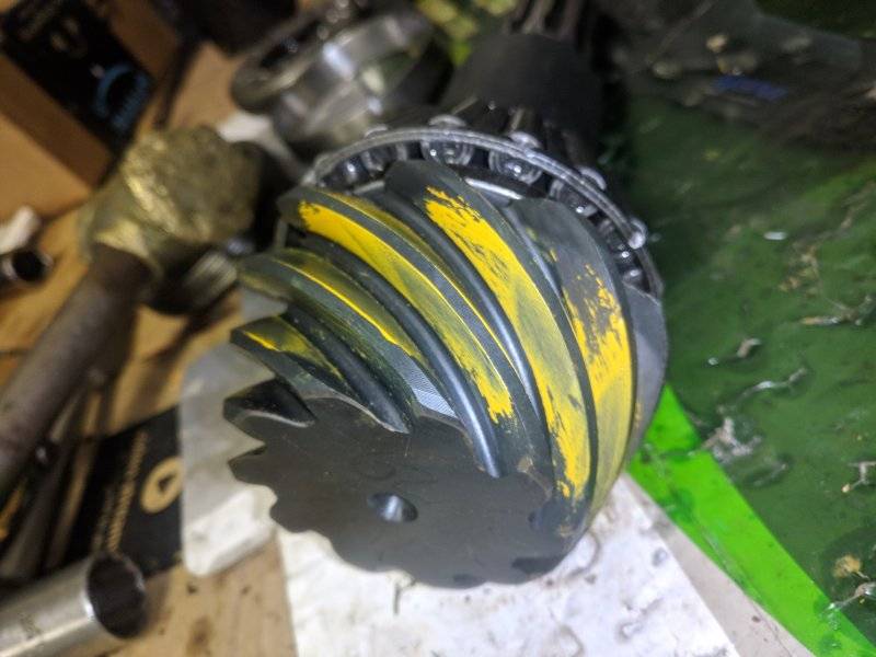

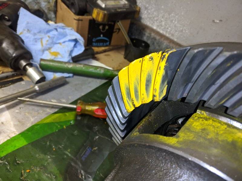

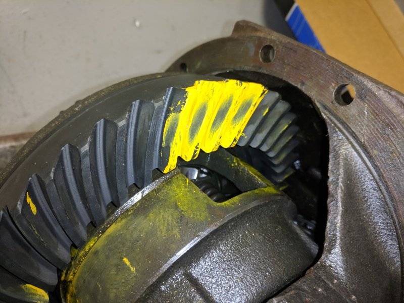

Ok.... i setup with .100 and i thought it looked good but a little high, went to .105 and didn't like it but don't wanna set it til i get your opinions..
First the .100 (btw.. is .100+ normal?)
Both of these are at .008 BL
BTW.. i am REALLY starting to hate this... just.. together, apart over and over...

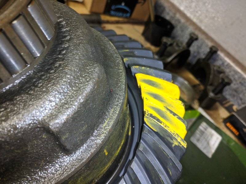

And this is the .105, on the 105 i felt the coast side pattern got a little odd, and the pinion didn't look as good..

I like the .100 better myself. It actually looks real good to my less than professional eye. I know you are tired of messing with it but I would try a .095 to .097 setup to make sure you are in the zone.
