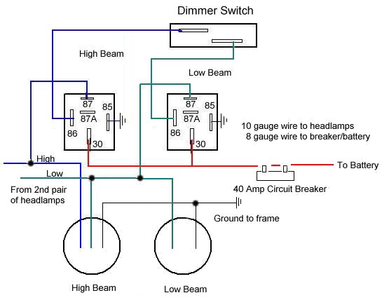

Look into the MAD amp gauge bypass. And do a separate headlight harness with relays that will help.
