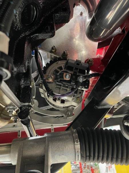

I personally like the MIDI fuse for the alternator circuit. Leave the MEGA fuse for the main circuit. Just be cognizant of the fuse curves and be aware of required temperature de-rating when choosing your amp size.
I mounted the MIDI fuse on the back of the alternator and added one at the battery. I think I ended up with a 90 amp - picture shows a 60 amp because I was awaiting for the 90 to show up.

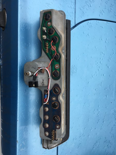

I use a cheap voltmeter from the auto parts store, tear it apart, and splice the movement into the factory cluster. The trick is to find one that sweeps the correct direction for your application.
This is the back of the cluster on a '68 Dart I did. I built my own solid state 5v voltage regulator (E-berg did an article on this in Mopar Action years ago but you can buy plug-and-play ones now) and took off power for the volt meter from there (small red and black wires running over to where the ammeter lugs were).
I glued the needle from the stock ammeter to the new movement with a drop of superglue:
I also put one of those solid state voltage regulators under the hood along with a properly protected "shunt" wire.
It ended up being a fun little car, I probably should have kept it!

I am curious, why? All stock? What issues were you having that lead you to decide to do this conversion? Did this resolve your issues? Was there an actual problem with the original ammeter or ammeter terminals/connections or more of someone said/wrote that that it should be done? Were the bulkhead Packard terminals by-passed as well?
The ammeter was melted and the charging system wasn't working at all. Yes, the bulkhead was bypassed as well.
The work was mostly based on stuff written by Rick Ehrenberg in Mopar Action. There was a little article about how to build the 5v voltage regulator out of Radio Shack parts, info about bypassing the bulkhead connector, making the alternator shunt wire modification, etc. It was a fun project to do and the Dart never tried to BBQ itself again after that.
I picked that car up from a guy that tried to fix a throttle shaft vacuum leak with JB Weld. Gave next to nothing for it and it ended up being too nice to part out. I fixed it up and daily drove it for a while before selling it and moving on. The last I saw it it was at the dealer's auto auction in Tyler, TX maybe winter 2020. I might entertain buying it back if I could find it...
I see, I’ve gutted a few voltage limiters myself and installed Radio Shack 5v regulator ICs as well in the past. Spent a lot of time at Radio Shacks back then. Prefer the RT Engineering units these days.
I’ve read the Ehrenberg articles, more of a complete redesigned approach as I recall (Densos and all). Certainly don’t remember him promoting this kind of band aid “shunt wire” fix, leaving all the stock unfused wiring in place with all circuit protection defeated, as is being promoted widely more recently.
