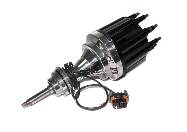

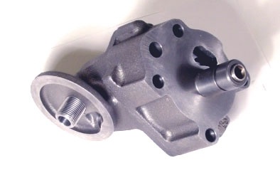

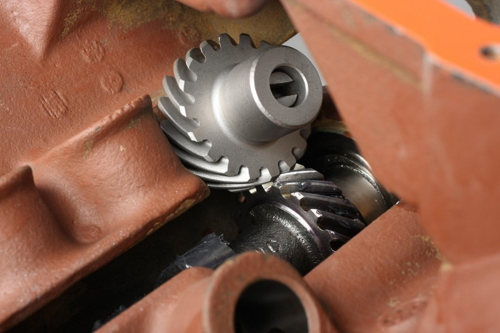

If it won't spin while spinning the motor over, it could be only a couple of things...but here are some pics of the components to help you understand how they work together...mopars use a tang on the dizzy ( like a common screwdriver)The gear is on the oil pump input shaft which is turned by the cam which is spun in turn by the crank via the timing chain...if the motor is spinning and the rotor is not it's has to be one of these companents and I would think if either have failed it would definitely be audible.
The one pic just shows how the cam and pump shaft gear engage..The only other thing could be your timing chain.
