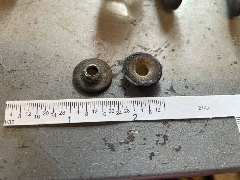

Hello everyone, I have my 72 Charger torn down and working on each section to get it ready for paint. I have a bag of six washers that didn’t get tied to what they came off of. If anyone can help me it would be greatly appreciated! Attached is a picture. Thanks AJ
Look like wiper motor bushing washers. 2 speed motor?
They don’t look familiar to me.
Wiper motor (either 2 or 3 speeds) doesn’t use washers, but bushings with internal sleeve inserts… higher/longer than these, and just 3.
Now THESE pieces seems to be pretty much similar but with the sleeve cut?
Aside this, the one on the right it seems to be got some body foam gasket attached
Going by the under-body sealer (black goop) I am thinking towards the front end - maybe around radiator support - underneath, maybe front fender fixing points, or belly pan valance in front of radiator.
No… being six I can think on the quarter extensions (3rd gens use 3 each). But they use to be bell shaped kinda speed nuts, not a separated washer from the nut.
Now that I think of it. The Blower motor on AC cars use that style of washer on the bushings as well and Natcho is correct on the sleeve on the wiper motor bushings.
T2R9, you may be on to something. I found the bag of washers near my parts for the heater/ac box. I’ll have to check that when I get home from work!
The quantity of 6 still has me wondering.

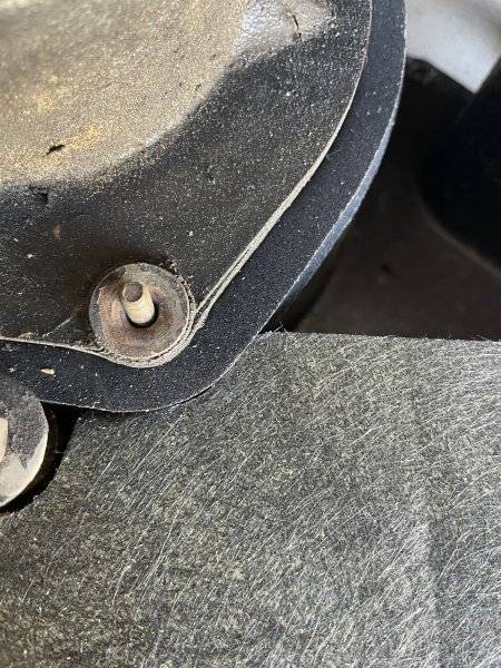

That was it! Check out the pictures
this is the motor house mount with the rubber only
here it is with the washer
the stud on the heater box is too small for the hole
with the washer it is a perfect fit. There is one washer on each side
Thanks for the advice on this
