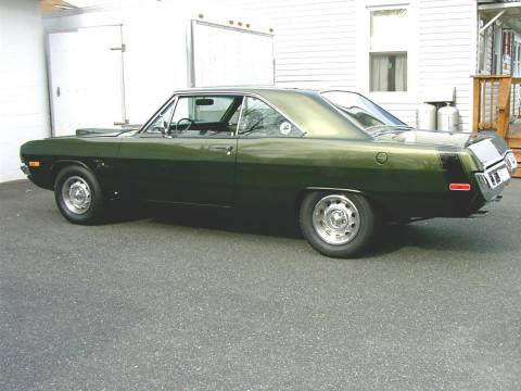

Mild 383 that was in my sons Dart a few years ago:
Stock shortblock with stock bore that I rebuilt.
452 heads that we pocket ported the bowls and used Crane single springs.
Heads were milled to get a true 9.5 comp.
MP .484 cam with adv 284 duration on a 104 centerline.
Stock rockers with shims under shaft for .020 lifter preload.
Stock dist I recurved and MP orange ECU.
Performer RPM intake with 750 DP.
CPPA headers and 2-1/2" exh.
727 trans with reverse manual V/B and Turbo Action 3000 10" converter.
3.91 gears and used McCreary G/60-15 tires with just SS springs.
This was in his 72 Dart that weighed 3550 with him in it. Ran a best of 12.31 @ 110. Had a great sounding idle with the .484 cam and it ran good for what it was. Ron
