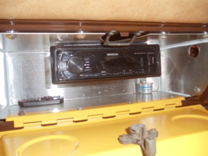

Had the local (Mexican) stainless steel fabricators (that make stainless steel sinks for restaurants) fabricate a package shelf and glove box liner for me. Holes for lamp, radio antenna, and radio wire loom were included in the glove box construction. I marked/drilled the holes for the fasteners myself to make sure things lined up perfectly. This for my '72 Satellite.
