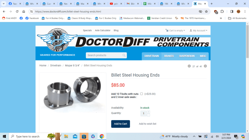

I'm stinkin it is.....who charges that or less these days?$85/hr? Wow is that cheap!

Without calling who knows. The web page does say 2024.That must be an old price page. It's $85 an hour to get your oil changed isn't it?
