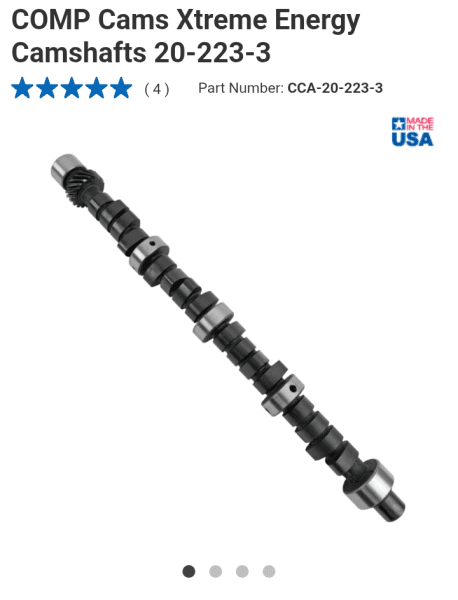

I have the camshaft picked out but I'm looking at 340 j,x or new aluminum heads.
