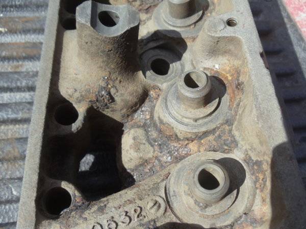

Hey guys. Quick question for you Gurus. my the heads on my 340 have a casting number of 3418915 from a 1970 340. my question is what is the number that is rivited on the next port? its not cast into the head and reads just 4 digits "0202"? anybody know what this means?

It's not 0202, it's upside down in the picture and it says 03060. that is March 6 1970 and it's not riveted it's how the plate is attached to the casting mold and just look's look's like a rivet.

they should be 2.02 intakes in 70
