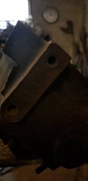

Just look for the hp stamping on the front of the head where the alt bolts and the L and K casting doesn't mean anything I have seen both with the 1.74 exhaust valve

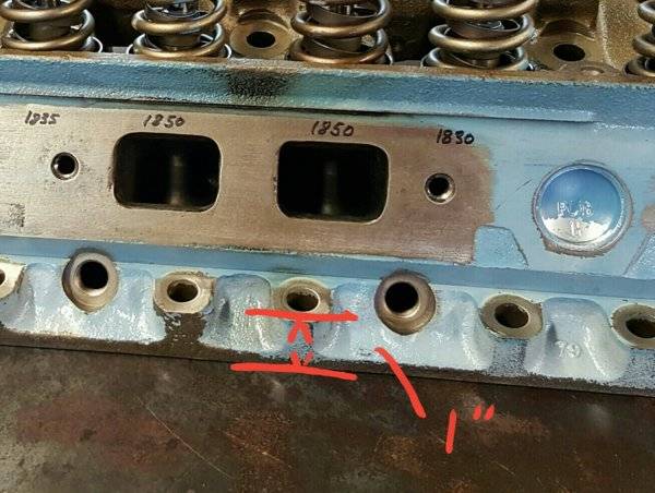

the lower head bolt boss will measure very close to 1.00" in thickness on an unmilled head.
Am I correct to assume that you are referring to the thinnest area on the bottom of the head, where it contacts the block?

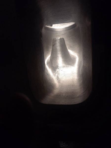

but bowl blending and opening the bowl with a cutter when putting in the larger ex really helps

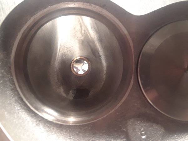

I have ported, and worked on, several sets of 915 heads. The port layouts are all the same as the 906 heads. All the 906 heads have the larger 1.74 ex valves. In 1967 the 915 heads came on all 440s, but only the GTX and Dodge RT had the HP 915s with the larger ex valve. Yes, you can have the 1.60 ex valve heads opened up to the larger 1.74 ex valves. Or you can go all the way up to the 1.81 ex valves. When doing this, get the port pocket opened up some to improve flow. You can also install larger 2.14 intake valves. These heads respond well to mild porting, but it isn't cost effective unless you do it yourself. Alum heads are relatively cheap, flow well, and are much lighter.

and do not even think of installing the 1.88 Max wedge exhaust valves (The motor home valves are the best quality SIL-XB intakes and Inconel headed exhausts both with thick industrial hard chrome stems- the 2.14 1.81 valves do flow better and both flow better with some hand work
The motor home valves last longer under street or HD use (the center two ex valves run hot)
Also do not try and drill the heads around the plugs like some 452's

Thank you. I've seen some heads that had an HP stamping on the boss where the alternator bolts too.
