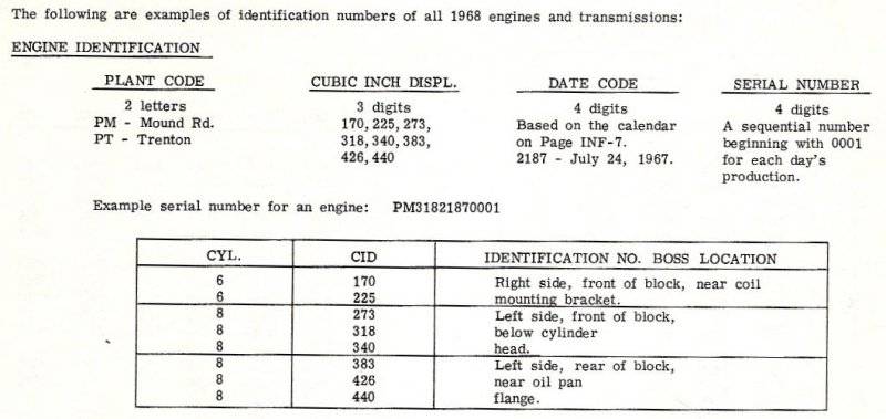

From the parts book:
P = Premium Fuel
Link to 10,000 day calendar to determine assembly date: Chrysler's 10,000-Day Calendar
As stated above:
T=Trenton
440= 440 cu in
P=Premium fuel
2238=Wednesday, September 13, 1967
1943=The 1,943rd engine built that day (wow, that's a lot of engines)

As stated above:
T=Trenton
440= 440 cu in
P=Premium fuel
There should be some stampings on the top pad with a little more info

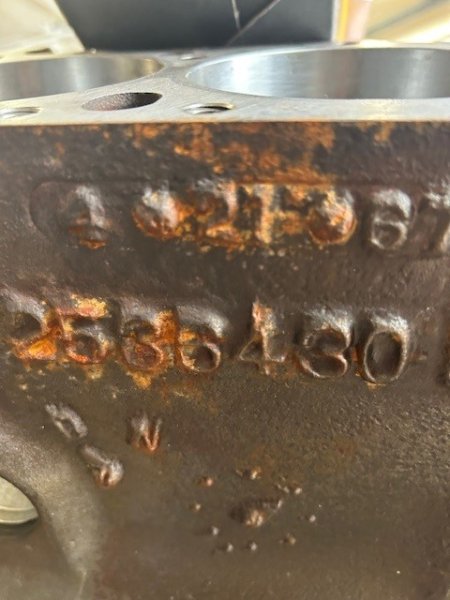

Correction - Cast date is 4-21-67

Show us some pictures of the numbers, top pad, oil pan rail, casting numbers.
Nnumbers on pad by distributor are:
D440
9 13 2
A
2900
(P)T440P22381943
