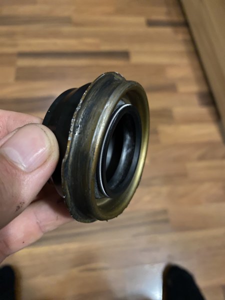

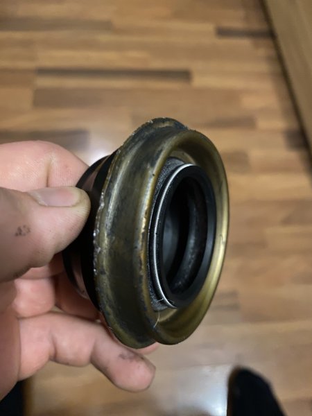

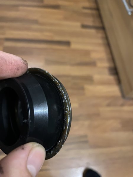

Wanted to install the new tail shaft seal on my transmission. Unfortunately I slipped a few times while hammering it. Going to try it again tomorrow. Is it still usable without leaking like crazy?

I have a stash of old exhaust pipe, different sizes from 1" to 3",
kept 6"-ish long pieces, that I use to put seals like that in
put a lil steel plate or a board over the end & easy hammering, the seal home
work smarter not harder
good luck
should still work, if you have any doubt go get a new seal
Probably OK but doing anything twice is a PITA so unless pressed for time I would get another seal.
