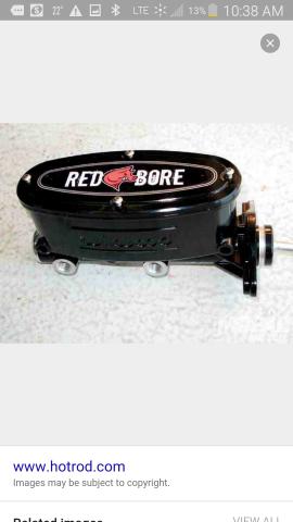

Never tried them but Just Suspension offered an MC called Red Bore that's supposed to significantly lower the amount of pressure reqired to stop the car??
Doesn't seem like they make it anymore - I see mention of it online, but their website doesn't mention it at all.
