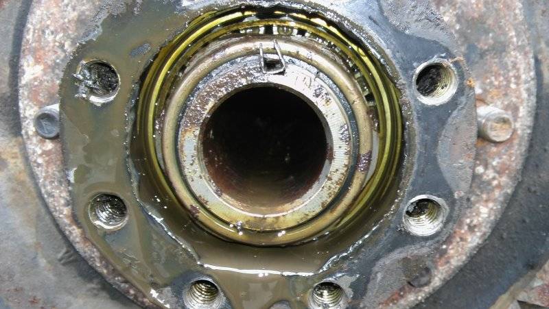

1984 Dodge 4x4 with a Dana rear.

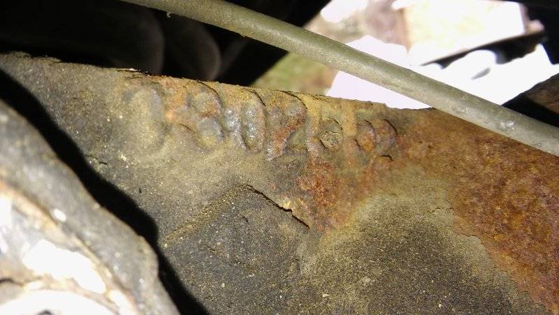

C30255 and 291B cast into it.
What socket size is this hub nut?
What's that U shaped thing at the top?

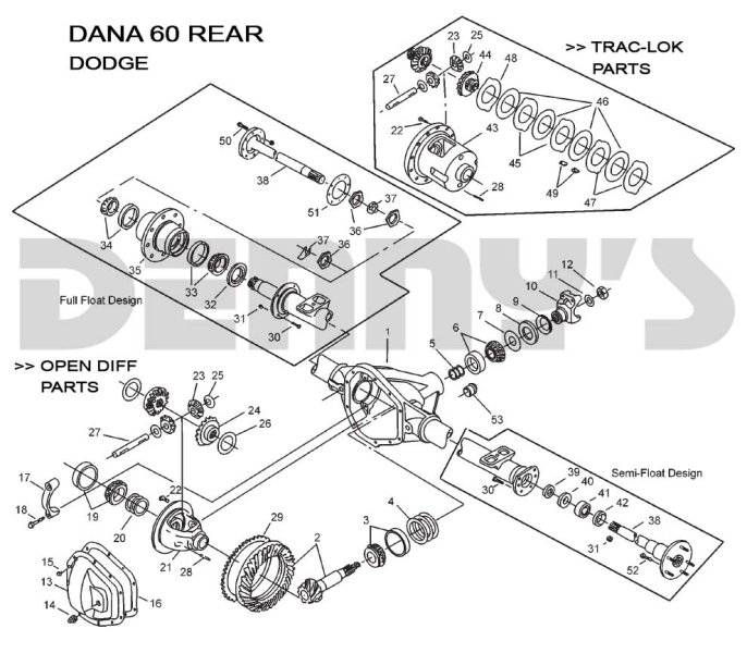

I do not see it in the exploded view.

Your diagram is of a semi floating rear axle. The picture is of a hub from a full floating rear axle. Some 3/4 and all 1 ton trucks have full floating rear axles.
The diagram shows both semi, and full float designs.
The u clip appears to be the lock, pull it out and may be able to spin the nut off by hand
