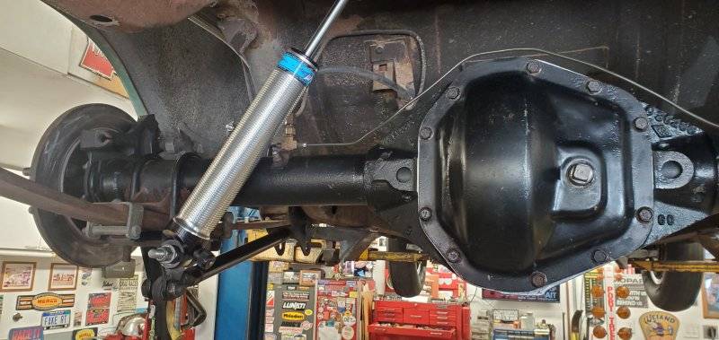

This was an 8 lug full floater taken out of a Ford F250 4wd. I cut it down. Added ends, axles, and a spool. Even ran the original 3.54 gears until recently swapping to a 4.10
