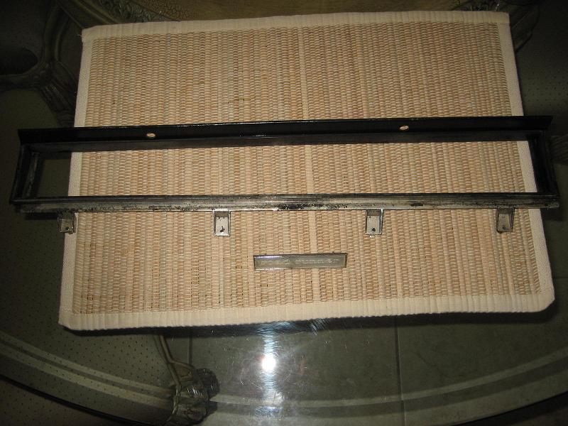

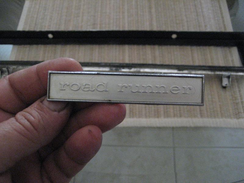

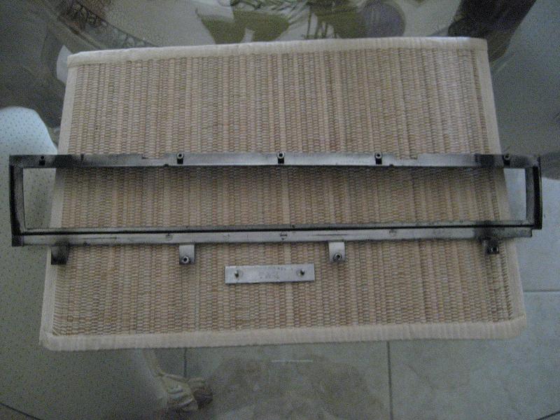

Here are the pic's. Cluster bezel has no cracks at all, just worn chrome. You will find most do paint these as the repops are $200 plus shipping. The bezel will screw directly to your cluster. I would guess shipping to be no more than $15.

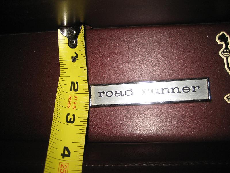

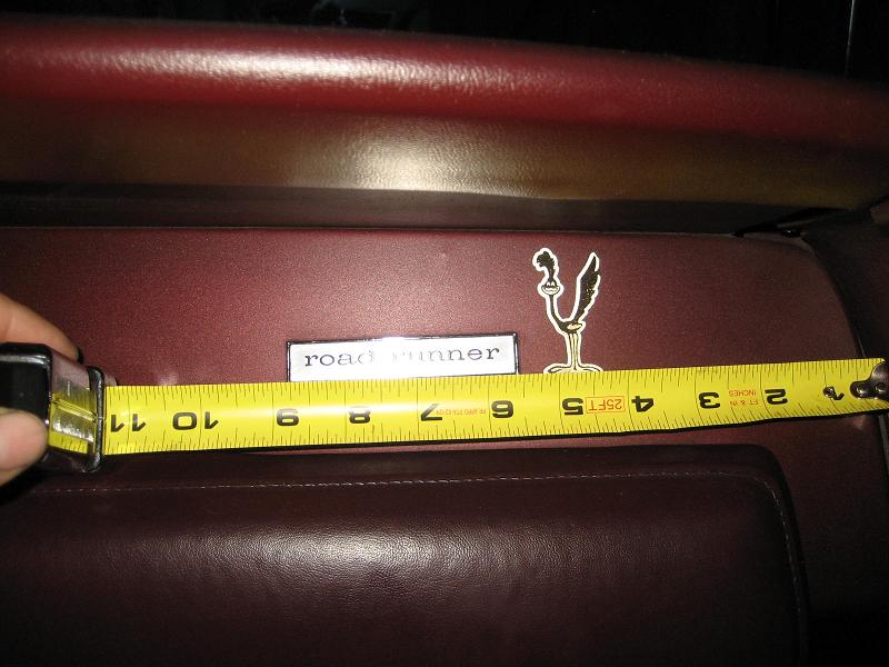

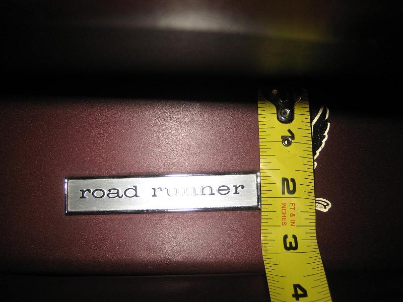

These may help also. From my org 68, placement is the same for 69 just a different bird sticker.
