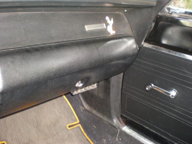

Hey just while i'm thinking of it do you have to pop the whole dash to get the metal behind where the satellite panels were? where the roadrunner emblem and decal sit. Just wondering so i can fix the holes and repaint it.
So i painted the bezel i bought from 69runner (thanks again!) and it's ready to install but i'm not sure how to install it? How do i pop the leather on the dash out? I'm afraid i'll break something but i unscrewed everything and nothing comes out... Also like in my post above does the metal piece where the roadrunner emblem and decal are come out easily? So i can patch the holes and repaint it.
if by leather piece you mean the lower dash pad, that is held on by speed nuts from the back side of the dash and as for the metal you want to repaint you would have to pull out your entire dash witch would also involve removing your windshield
