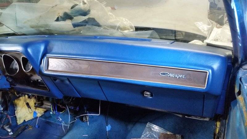

I did my dash with a cap a few years ago. I ended up taking a lot of time trimming, a little heat and more than the glue they give you to get it to turn out decent. The dash was out of the car so I could use many clamps and many pieces of wood to clamp it down here's the results in my 74 Rallye.

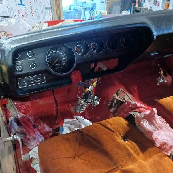

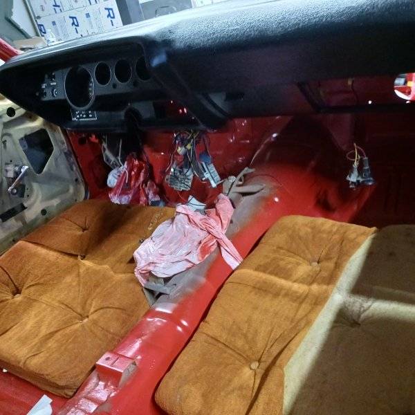

Here's the one I installed in the Challenger a few months ago. It appears to puffed up in the middle of the top along the speaker hole. I spent hours fitting this and it's okay for what it is. The E-body caps are much larger and have that speaker hole right in the top center with a lot of cap plastic around it, which doesn't seem to fit right. Both Challenger caps I've done have just been okay. The Charger looks great.

Yes, same company I bought the Charger one from. Again, it was bought several years ago for around $130. Much more expensive now. Preparation and patience and hours of fitting before gluing are the things required when using a dash cap. If these were show cars with concourse restorations, then I'd have the dash pads redone instead of a cap, but they can look good for what they are. As a side note, the first dash cap I installed was in 2004 in my sons 71 Challenger. What a disaster that turned out looking like. We took it out of the wrapper, applied the silicone glue and stuck it on. No clamps, no trimming, and not enough glue. To this day, it looks like crap. I'm hoping my son decides to replace it even though the car is in my shop here in Washington state and he's in Virginia. I won't pull it out by myself.
