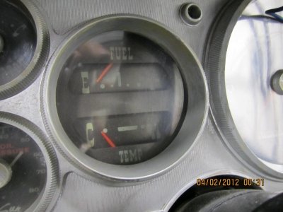

63 plymouth dash cluster,did the Fury come with the plastic chrome and the Belvedere & Savoy just have silver paint??I'd like to do the cluster face and get the lenses polished.

I think you will find they all used the same bezel.
Than mine were repainted before my ownership:toothy6: I have seen a few that redone and they were NICE!!!!

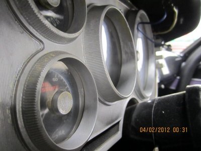

So all this may seem strange. But I build plastic models as a hobby, so i figured I would try this on my own to save money.
I took the dash pieces apart leaving me with just the plastic face.
I soaked it in oven cleaner in a sealed container. Left it in front of the window to make it react slowly. Then washed it with dish soap and water.
I sprayed it with Tamiya bright aluminum out of a can. After drying i masked off the bezels and top/bottom edge. To keep them shiny. I sprayed a dull coat to cut down the tone on the face. Removed the tape and there ya go.
I removed the clear plastic off the cluster and polished it slowly with Novus plastic polish. Starting with coarse and moving up to the final polish. Cleared them up and removed all the cleaning scratches from the past 48 years.
Wont win me any awards at the concourse level. But it will do.

Hemi-Itis this is my cluster face after I worked it over. I repainted the black and silver myself and it did not come out to bad. I also polished the lens with lens polish. Ron
You guys did a great job on those clusters:icon_thumright:I saw a dash that had been fresh,just done with new plastic chrome around the gauge clusters and it looked GREAT!!!It,s on my bucket list to do:icon_clown:
