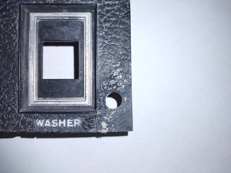

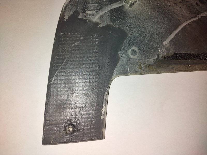

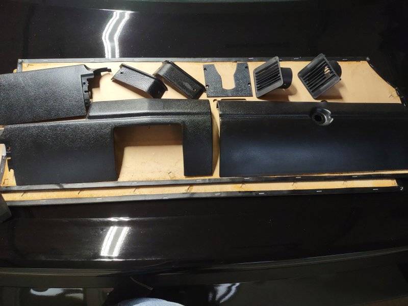

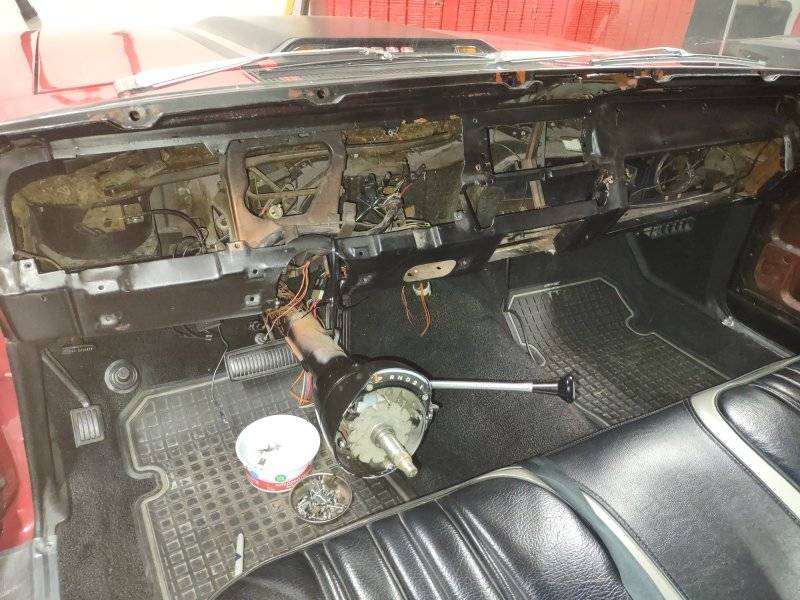

Started off just refreshing defroster vents on my new 70 Road Runner project, ended up stripping dash and refreshing it all. Repaired two pieces of broken dash bezel using JB Weld. Gauge bezel was missing corner, built it up with JB Weld, allowed to dry over night, thin coat again and clamped a piece of leather, dried then pulled leather off to give grain effect. Came out pretty good. I'll see after I paint and detail them. Upper and lower pads came out great used SEM landau black after adhesion promoter.
