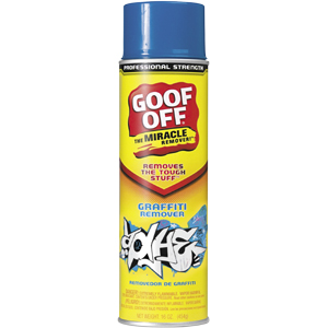

Anyone tried Dawn Power Dissolver, GoofOff Graffiti Remover, Klean Strip Aircraft Paint Remover for Plastics to remove old paint from plastic interior panels?

I went to a local car wash after work today and tried the Goof Off Graffiti Remover and the Dawn Power Dissolver. The test objects were two sets of kick panels that had been painted black. Set #1 was in worse condition. So, I shot one panel with each product; waited a few minutes and shot them with the high pressure wand. Some paint came off right away with the Goof Off but nothing happened witht the Dawn. So, set #2 (the good set) was sprayed on the back side with Goof Off; waited a few minutes and Wow! The paint peeled right off like a bad sunburn. Same thing on the front side. Took them home and washed them thoroughly with TSP (tri sodium phosphate) which Stacy David recommends using to prep plastic for paint to clean off all the old Armor All and oily residue. Now their ready for paint.
I don't know how these were prepped and painted before so I cannot account for the difference in the reaction of the GoofOff on one set over the other.
Maybe this will help some one else.
Good to know. Sounds like it works a little faster than the Easy Off.

Accidently typed brake cleaner instead of fluid. You are probably right, as I have never tried brake fluid before. I asked this same question on the site a month or 2 ago when I was cleaning up my interior pieces. I cant remember for sure, but I think someone else stated they had an adhesion problem after using brake fluid. Doesn't really matter I guess, but we do know that Easy Off and Goof Off graffiti remover work.
Brake fluid is oil and must be cleaned thoroughly before painting. Beware, some dish washing liquids leave a residue that cause fish eyes and/or adhesion woes. Brake fluid has to soak a while. Graffiti Remover is almost instantaneous.
