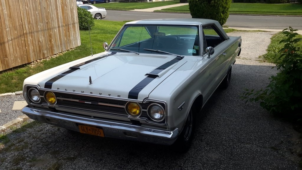

Day 1 owner of a 67 gtx with a few questions
Welcome to FBBO!! Beautiful diamond in the rough!
Love 67 Gitticks!

Welcome, Nice GTX you found yourself. It looks like in good shape to start with, the worst of it looks like a tail lite and chrome damaged. You should be able to find those here, these guys are very helpful.
Thanks, I have the tail light and bezel, the steering wheel is cracked too, but having it refurbished also. Thanks for the info on the trim and vinyl top, pictures soon!

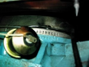

My 68 charger has no match numbers on it's motor because the motor/block was cast then built in late 67. I found out that some of the factory motor assemblers stamped the match number on the top edge of the bell house flange before 1/1/68...
Also the cast date on the block should be a few months before the car was assembled. So if that is so, what are the chances that a motor like that would not be the original.
IMO, a pre 68 with a motor cast date just before the car build date is as good and should be a valued as matching numbers..
