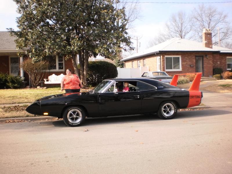

Several people build nice clones, here is mine. It was built by Larry Roper out of AR.

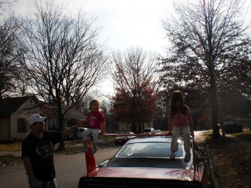

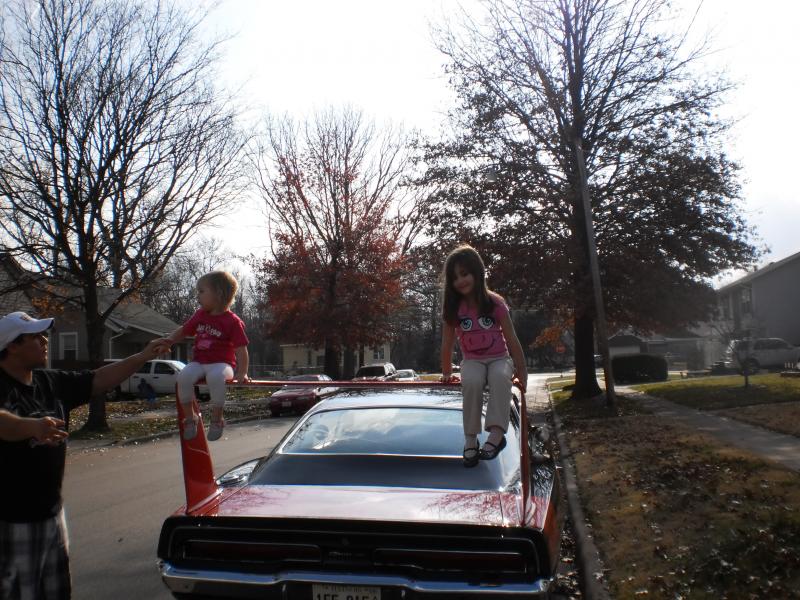

If I saw 2 little girls sitting on the wing of my daytona, I would **** a brick... Just sayin'
