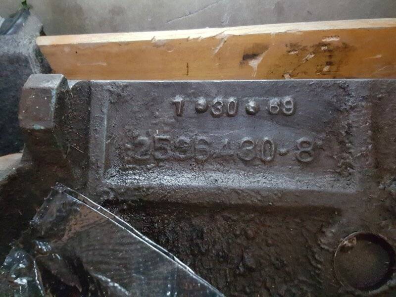

Can someone help me with decoding the year for this 440 block. The numbers on this block look to give different years. Has anyone seen something like this before?

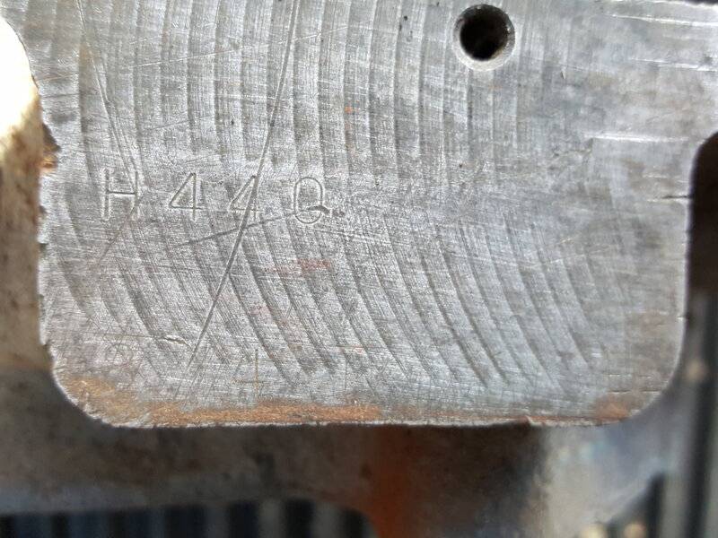

the top pad shows - H440 (which is 1972?)
the date code stamped on side of the block - 7-30-69 (late 1969 or early 70’ block?)

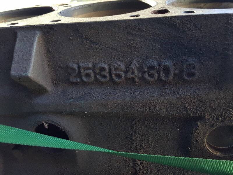

Casting #’s - 2536430-8

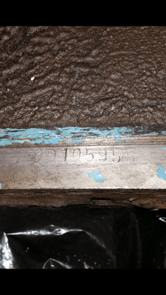

Serial # stamped on oil pan rail - 2D105955
Numbers on the bottom left corner of pad - 8 and 4, not sure what those mean.
My guess is the block is a late 69 or early 70, but somewhere along the lines the pad was stamped with a H440...?

Engine build date was 8/4/71
Block cast date 7/30/69
H 440 installed in a 72 automobile
The 2D10595 is the serial numbers 2 being the year 72, D the plant ? and the 10595 serial #

So being that the block was casted in 1969, Would that technically make it a 69’ block?
or would it technically be a 1972 block? being it was later built and installed in a 72’ automobile. Even though it was casted years earlier.
I’m thinking about selling the block. So I want to make sure I advertise it correctly.

For what ever reason that particular block didn't get assembled into a complete engine unit 8/4/71. That date would have been for a 72 automobile.
Actually the cast date would be a 70 block because 70 production was starting then.
Plant D is Belvidere ,Illinois

If memory serves, belvidere plant only assembled big cars, c-body and bigger. And the Vin on the pad just above the pan rail indicates a very early 72 build, which matches the August assy date. (New year vins started 1xxxxxx.)
