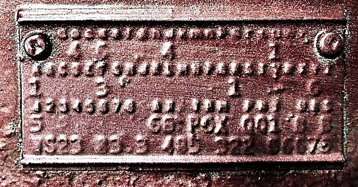

HelloI am looking to find out how this car was originally conceived. Any help is appreciated....
Thanks in advance....:)
WS23L71205760

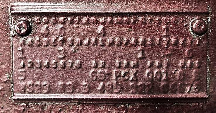

Hard to read. Looks like R/T with 440, 4 speed with 3.54 dana 60. Dark red metallic(QQ1?). 14 x 7.75 red stripe tires. March 22, 1967 scheduled production date. Black bucket seats. AM radio. 26 inch radiator. Black vinyl roof. My eyes are sore.
67 Dodge Coronet R/T, 440 4-speed 3:54 Dana, 26" radiator. Production date March 22, 1967.
QQ1 Dark Red Metallic, Black bucket seat interior, no console, black accent strip. R1 AM radio. A few other codes that I would have to look up.
Vinyl top code?
If it is a 6 under the Y, then my info says black vinyl top. It is hard to read. I could be wrong of course.
try this one... Looks like a 6 or 0.... I think 6.

Man I have seen some crusty fender tags in my time but that one looks like it's been there since the pyramids were built.
No doubt that one has been there since 1967. My guess is at least 3 paint jobs.
At least it's not rusty! :thumbsup:
d/6 = 426 = rear seat speaker
j/4 = 544 = body sill molding
u/1 = 691 = sold car/expedite = someone ordered it and is waiting for it.
F/3 = 363 = Coronet R/T package
06675 = rest of sales order number
