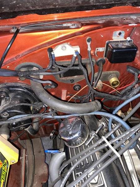

Hope this helps. Here in Europe its dark now I can send more pictures tomorrow by sunlight.
All linkages, cables, vacuum hoses etc are still attached and in good condition. I also have new hoses for the engine to firewall

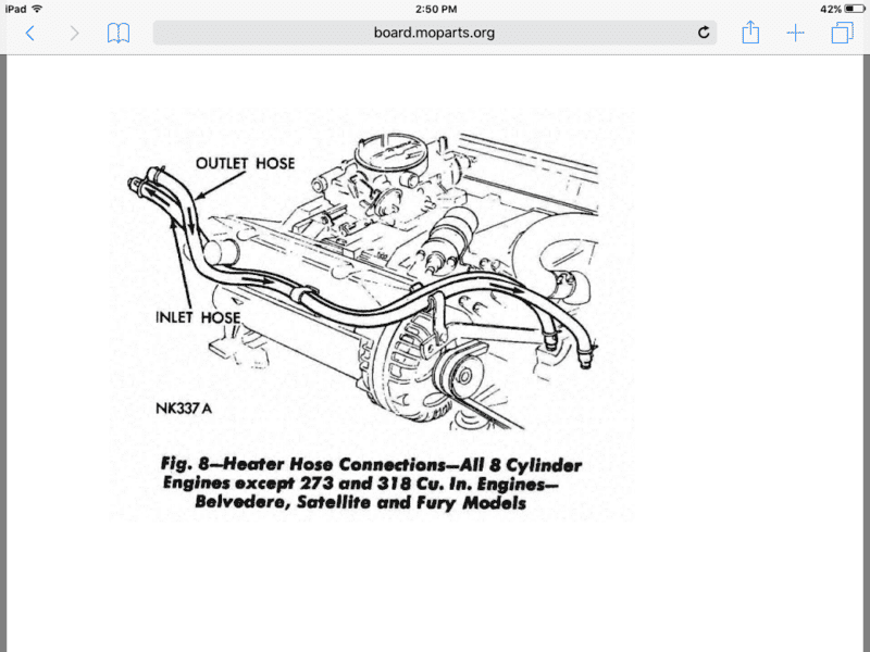

You got new hoses from the water pump to the heater core fittings (the outer pair, not the inner A/C ones) on the cowl firewall? I presume the fan still works to blow air? And the levers, when set to defrost, direct air flow through the vents in the top of the dash?

The Fan for the heater box still works-same as the dash vents. I also have the hoses for the block that lead to the firewall.

Duct hoses are installed. Yeah, the air must be heated for inspection. So my water valve is still needed even the other AC components are removed or am I able to hook up the engine hoses directly to the firewall tubes like a non-AC car?

Like Rishi posted, yes you can run your coolant lines to the heater core and use it without the AC parts hooked up.
Just make sure your valve and core are good .
