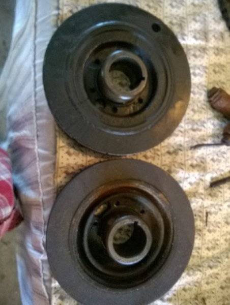

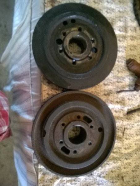

it looks the same, but I will inspect it more closely tomorrow. The pistons are flat top but have two tiny half moon cut outs along the edge..
The narrower rods are .10 under. The crank in the 74 is stock. So when I get the block done I will send the crank too. The balancers are the same size but the 74 is lighter weight with a smaller pulley. And it has a chip off on the edge.
If the pic's are of the front of balancers the view to see the difference is from the back I believe.
back side. Never mind about the pulley's the smaller one is the fan pulley. lol.

So the top one in my pics is more like the six pack balancer. That came off of the modified 73 passenger car 440 with the LY rods.

thanks for the pics
the six pack ballancer should have come from the motor with the heavy six pack rods
if you look on the lower e=bay picture posted above by Fran you can see at the bottom the inner ring is not round- their is weight missing- that one should go with the 6 pack rods and crank
