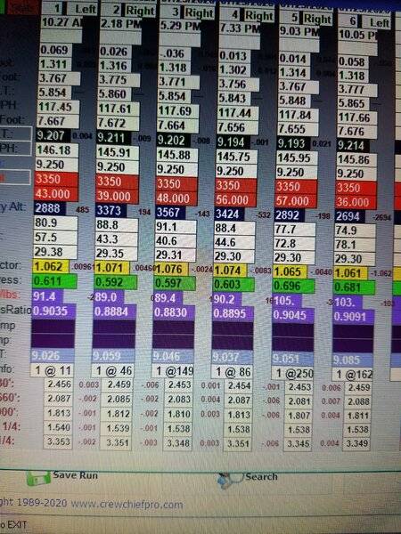

Saturday this is always a good event. The car has been apart a month for upgrades. New 16 volt system, new rear shocks, rebuilt front shocks and calipers, new front tires, rebuilt carbs.
Zero test time. We'll see how it goes. Shock adjustment is a guess at this point.

Didnt win but it was a good day. The car was fantastic. With the new rear shocks every 60ft was with in .01 except 1 . Only made 2 sets of adjustment as we were in eliminations. I was a little in rd 4. Also got out of the groove, car fell off .02. Lost by .005. That last 2 runs I set the dial .01 quicker than the weather predicted. All the dials show 9.25. But they were not it ran dead on every pass except #6.
