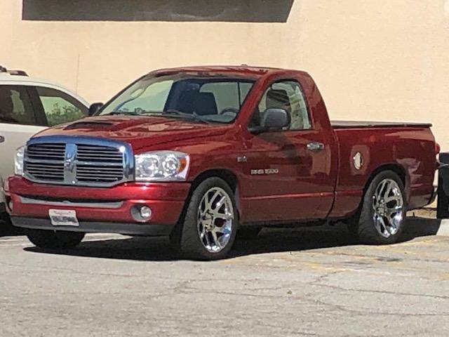

I have 347,000 miles on mine. I do a LOT of commuting for work.
Well, I used to. I won't anymore. To heck with that!
