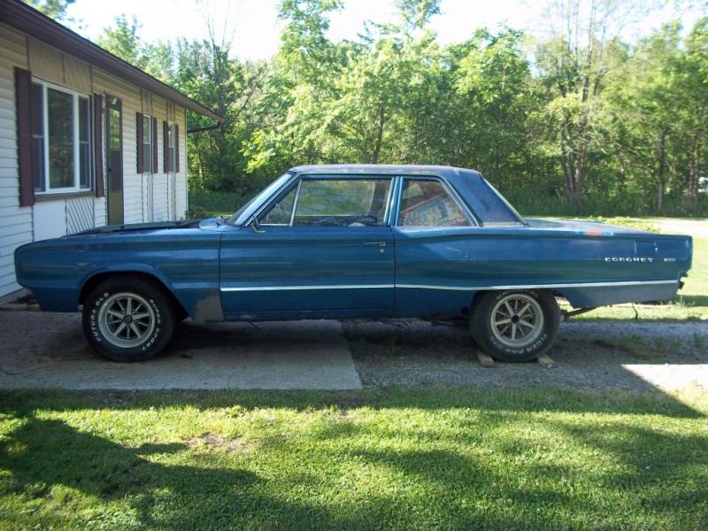

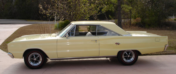

1st is sedan or post car second is hard top...pretty easy to see on the 66-67's
