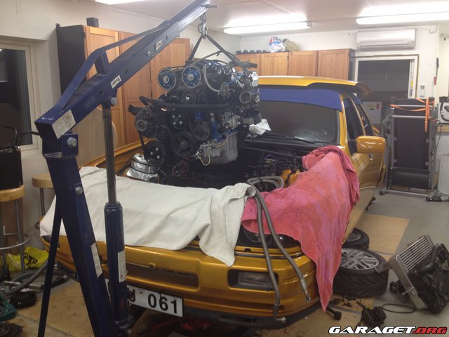

Then I must confess for I have sinned. I have been tinkering about with a Ford. Please forgive me. Engine swap and new Quaife LSD in the rear so I'm not a bit worried about the Sure Grip issue. Damn it that this is my first old car so I have to ask all the questions. Thanks for helping me out though.
