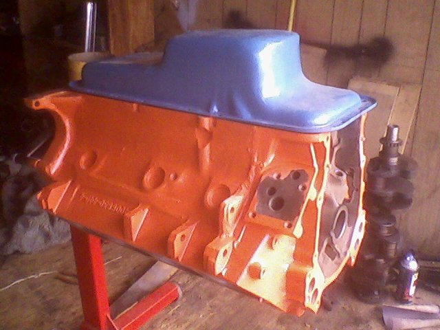

I suspect my dipstick is off. It reads low with the correct amount of oil added. The guy who owned it before raced it so I'm wondering if he changed out the oil pan. Is there any trick to figuring out the correct oil level if you suspect your dipstick is off or a bigger oil pan was installed?
on an original 1970 383
crawl under there and look . you can tell if the pan is aftermarket or oversize. a factory pan will look similar to this

Does the pan make a difference ? The dipstick just protrudes past the block. A deep pan wouldn't change how much the dip stick protrudes. Maybe I'm wrong.
You are correct,,, A dipstick that is known to be accurate will remain accurate regardless of adding a higher capacity oil pan. However, if the OP has no idea of the origins of the dipstick,,, He can not verify the markings of fluid level without first knowing the capacity of his oilpan.
