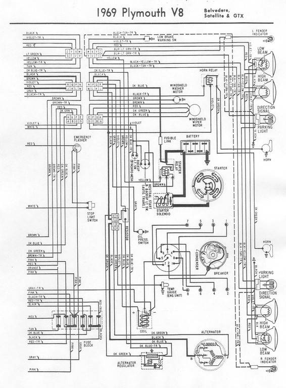

Based on the diagram below there should just be one wire to disconnect. The Black Yellow Tracer in slot U of the bulkhead connector.
^^^ This advice above is the way to fix this. You pull out the black-with-yellow-tracer wire from the bulkhead connector at postion U, tape it up, and then you can restore it if you ever need to do so. This will disable the front parking lights only. The rear parking lights will still work in the middle position of the headligth switch as well as the license plate light.
