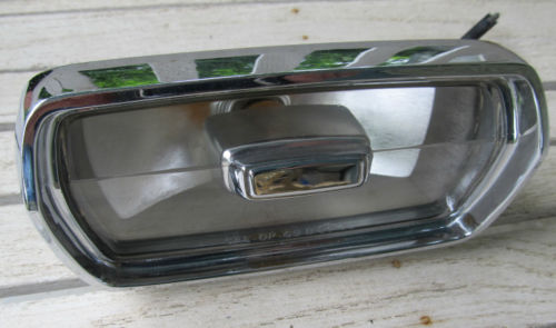

You could try 1969 Cuda front parking lights
I guess you could try to get them to fit but then again - the car won't have it's stock look in the front which I really would like to keep. I'll post a picture once I've mounted the lights
