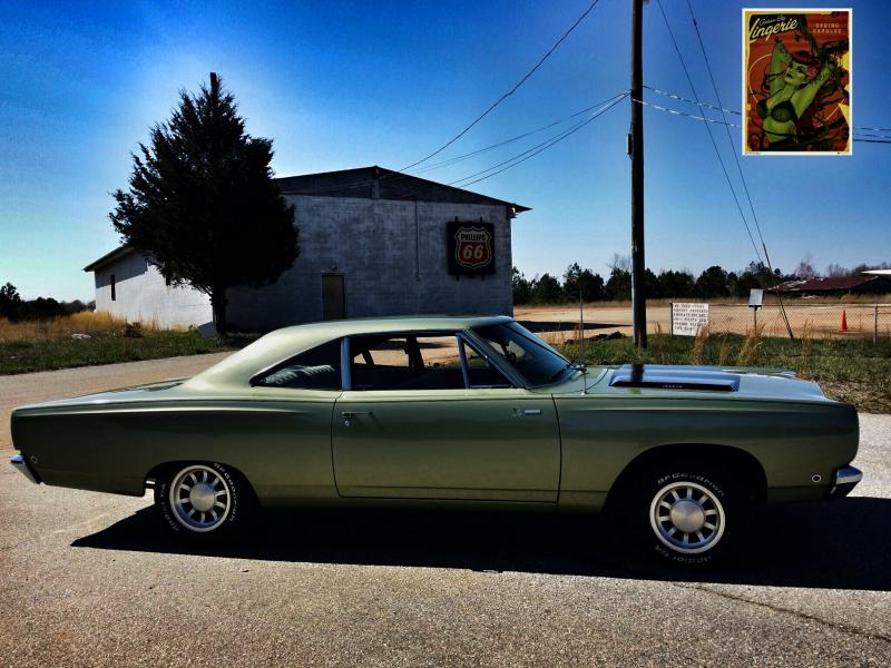

I have manual drums on all 4'sides of my 68 roadrunner. I bought the 4 wheel manual disc brake kit from summit along with a wildwood adjustable prop valve. Do I also need to buy a master cylinder too? Before anyone says anything about how my car sits my shocks are gone in the back haha PicsArt_1427661035593~2.jpg

Drooping rear is not due to shockers but sagged springs, shockers don't hold up any weight, they just stop the bouncing (except in the case of air shockers, and don't get me started on those.) I would wind the front down a little and say it's a low rider...

Yeah air shocks are horrible imo. That's what is on there now because the previous owner put them on. I bought some bilstein shocks to put on, guess I'll need to get new leaf springs too

you can adjust torsion bar height in front. looks like you pulled the hemi out!
