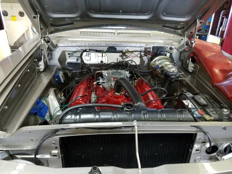

Here's a view of my the booster/MC. It's an 8-in booster and sits 3-in below (top of booster measurement) the top of the FW.
Forgot you have a ’64, mine is a ’63 – there were significant changes made in the cowl area btw these years. If I recollect, not sure, the single diaphragm stock boosters of the era though were a larger diameter. Maybe a fellow member with a 64-65 will post what they have..
Nice car!!! I can't, or don't want to believe, that there is no aftermarket booster that fits. Yours's did...
The installation looks like a GM style master cylinder. Not lsure of the booster but its not Mopar. Might be a Midland-Ross (circumferential clamp band) or possible be Dr Diff kit......

Correct, it's a GM deal, mid-60's vette MC. I know because the one in the kit, after repeated bench bleeding, wouldn't stop the bubbles in one reservoir. I hunted for an exact replacement finding the MC, despite the MC being for front & rear disk setup - only have front disks.
