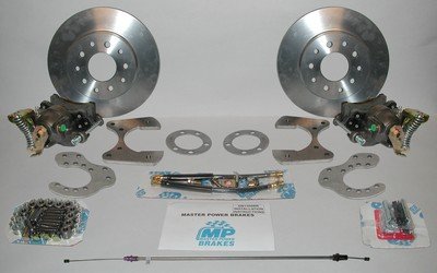

In the pic below you will see THIS MasterPower brake kit comes with a "E-brake" cable that goes to each caliper.
Check your application and the Kit the previous owner used.

it has the levers for hook but no cables.
I'll take this one.......
if it's the A-155 kit that I have on my car they just didn't hook it up from pure lazy.... there's an L bracket that bolts up w/ the caliper bracket, and the factory cables go through this bracket and hook into place on the caliper, when the e-brake is applied, it simply clamps the pads together on the rotor
