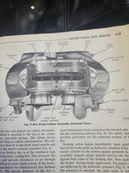

I am in the process of rebuilding my front suspension and brakes on a 1969 charger. The car is a factory front disc brake car. I am keeping the stock suspension. I am looking at options for the caliper/rotor replacements. What options are there for keeping my stock spindles? I have been in communications with Cass at Doctor Diff who has been helpful as they have been recommended on this forum. The feedback I am getting is that there are not a lot of options for keeping my stock spindles. I'd rather use my stock spindles as there is nothing wrong with them, but understand if the options are limited. Any input would be appreciated. Sidenote, I am wanting to put a 15x8 wheel in the front as this is what I have on a different car (68 charger), but it's not an apples to apples comparison because that car had a disc brake conversion done from factory drum brakes. Thanks in advance
