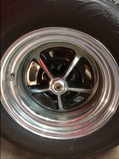

My kit from Doctor Diff is different than the Wilwood you guys are asking about. Look at the last pic in my original posting of this thread. That is my front wheel with the center spinner cap left off. There is plenty of room for the Magnum center cap. I just left them off until I get the front end re-aligned.
These are the wheels that are on the car. The fronts worked fine after my modification to the disc hub.
