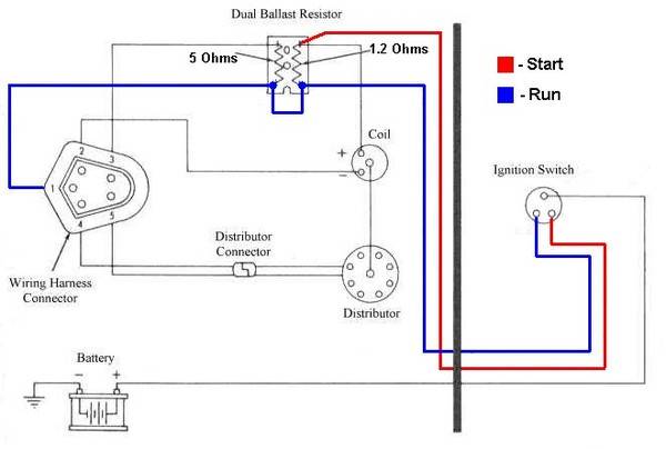

This is the 4 pin ECU diagram

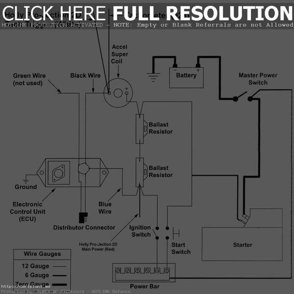

Here is the 5 pin Diagram.

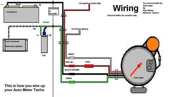

Here is a diagram with tach wiring included.

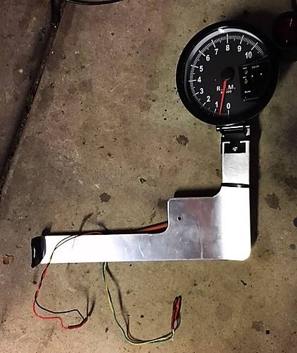

I removed the green Tach wire from my ignition coil and have taken the unit off the car. What am I missing here? It feels like my timing is now thrown off? Doesn't make sense.

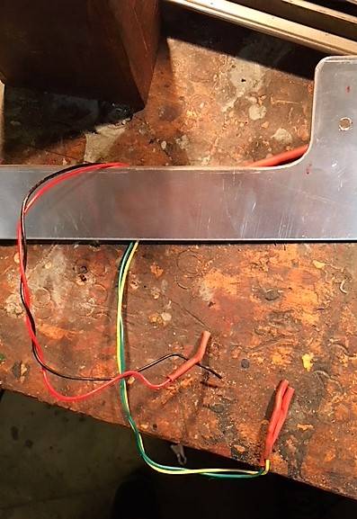

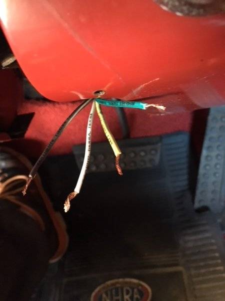

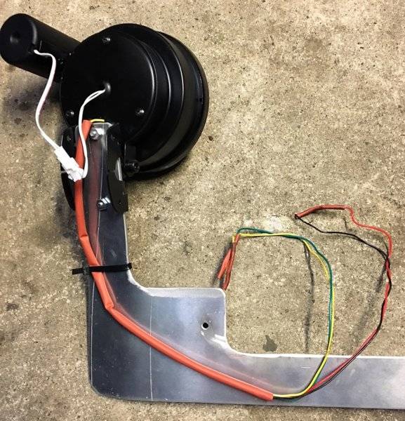

Here are the 4 wires removed from the TAC.
That is trailer wiring lol.. A tach only needs a wire from the negative at the coil and a ground. If I am not mistaken maybe a wire from the lighting harness for face lighting. Can you show a picture of the tach and its wiring?
Hook it all back up and see if the problem goes away. If not then I would say you have some wiring issues. Might have a wire jumping to ground.
Wish I could, the dude who installed the TAC didn't use correct color wires and I didn't make a mental note of wires when they came off. Dang it!
What kind of ignition system do you have under the hood? Is it like anything I posted above?
Is there a brand name for that tach? maybe find a wiring diagram to see what each color wire goes to on it. The follow the wires that are coming out of the dash. I believe those will be the culprit.
Try this picture.. See if the wires under that orange/red sheathing correspond to this.

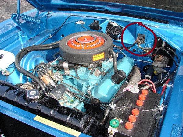

Do make sure to check all of the wiring at the bulkhead connection. Both under the dash and at the firewall.
Where all the wiring goes thru firewall. 2-3 rectangular plugs.
Left side of the brake booster under the hood. Square block with all the wiring going into it. Under the dash its above the gas pedal.
Not your car but it should be in pretty much the same place.
