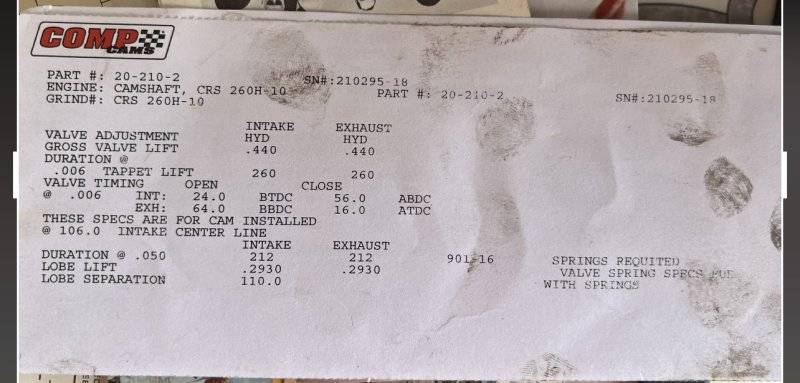

If it helps it’s a 318, automatic, 4bbl Carter, 340 edlebrock manifold and Comp Cam. Running non-ethanol gas. I found the Cam receipt but the numbers don’t mean much to me (if anyone could give me more info, I’ve attached a picture of it). Not sure if it matters but it also has headers and flowmaster mufflers.

not sure what’ more info’ you’re looking for. It’s all on the cam card. It’s a little baby cam suitable for a 318 that is probably designed to make good torque.

Thanks! I’m new to aftermarket cams so I guess I was just wondering if the numbers on the receipt greatly impacted the way it should be tuned/timed from a stock setup.

.440 lift is .040 more than the factory .400 lift "318 cam".
That's a sizeable increase as the closer you get to .500 lift the more problems you start running into, like milling the valve guides.
My guess is the duration is a relative increase as well (don't have stock spec in front of me).
That's a "single pattern" cam, meaning the intake and exhaust are the same.
Cams like that work best with increased exhaust flow, commonly done with headers and duals, but also with installing larger exhaust valves.

Also depends on your compression. Most teens don't have much and pretty much no quench either. I give my engines the timing they like and have had a couple that liked more....a lot more. And I like a cam card that tells me what's happening at .050 instead of .006 . The .006 figure makes the cam 'look' bigger than it actually is and there's not much happening at .006 lift. Basically, you have a cam that's barely a step up from stock. Do a compression test with all the plugs out and the throttle wide open. That will tell you some more info.
