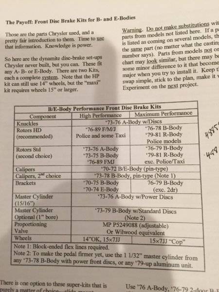

I have that book somewhere, of course since I was looking for it it can't be found. What are you needing, maybe I can give you a hand? I wanted to find the section showing the MOOG numbers for the front end components on b-bodies.
I have the '73 A body knuckles, HD rotors from '76 - '78 B body and that's it so far the brackets look like they might be a problem. Also do I use '73 A body ball joints?
Also I don't see MOOG numbers for all of the components, I do see some but random in the book. I'll look again.
Nice write up, Looks very similar to the Tom Condran book. They list P/N 4126545 for the 11 3/4" rotor, I have 4885579 rotor, looks the same also 11 3/4" rotor.
Ball joints stay the same as I remember. Unless you are doing that swap on a 73 and older A body or newer with drums. Its best to get the brake stuff, calipers/rotors/caliper brackets off the same car so you don't have match up issues. If you are running 15" wheels, go for the bigger rotor setup which is 11 3/4". More leverage and surface area for better stopping. You can also use F/M/J spindles plus they are a good source for your brake components. Where is Greenwood? If you are close enough, the Fall Fling is on the 28th in Van Nuys and maybe you can score some needed pieces there otherwise Pick a Part/Ecology is your choice for yards to get a deal.

fantastic site but I'm sticking with what the book shows.
