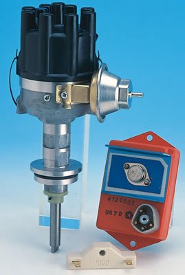

The Mopar Performance distributors fit Poly's too:
http://www.summitracing.com/parts/dcc-3690426/media/images
