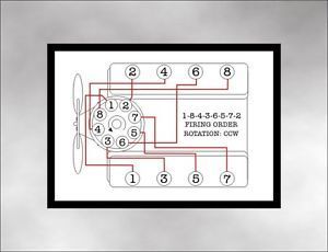

So where should Number one wire be when looking at my distributor top left or right. Been looking for pictures but having problems finding them. Thanks for help. Blue
Should be and where it really is can be 2 different things. I can static time an engine with #1 in any location. Get a factory service manual if you want to do it right.So where should Number one wire be when looking at my distributor top left or right. Been looking for pictures but having problems finding them. Thanks for help. Blue
I was thinking it was around the 5 o’clock position?Number 1 cylinder is the front one on the drivers side. If the distributor gear was installed correctly, you should be able to follow that plug wire back to the distributor and find it at the 7 Oclock position looking at your distributor from the front of the car. If it is in any other position, your distributor gear was not installed properly.
Correct if you are standing by right front fender looking at the distributor......I said 7 O'clock from the front. It does matter where you are standing.If you want to do it per the book, at TDC set the intermediate shaft so that the distributor slot is pointed from front to back in line with the crank center line. This will put the rotor somewhere around 5 O'clock #1.
I just assumed standing at the front of the car meant standing by the front fender looking at the distributor.Correct if you are standing by right front fender looking at the distributor......I said 7 O'clock from the front. It does matter where you are standing.

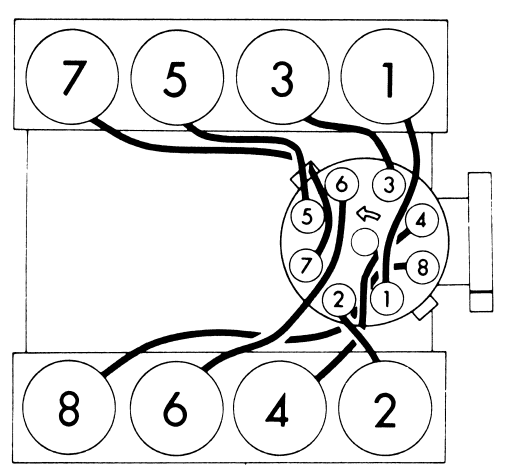

Ideally number 8 wire should exit directly north (towards the passenger seat) from the distributor cap.If it's in roughly the factory location....your vacuum pod will be free of any obstructions and pointing at around 2:30 o'clock - viewed from the grill.
(Timing subject to variations)![]()
I didn't dispute your statement either. However, it is pretty hard to track down that number one plug wire (at least for me) from the right fender position. My comment was to the question that started this thread. He was not asking about proper installation of the distributor or drive.I did not dispute your statement.
However, when people are adjusting the intermediate shaft to correct orientation and inserting the distributor, they are more than likely looking down the hole from the passenger side of the engine as this gives you line of sight for alignment.
