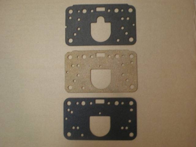

Any chance of getting a picture and number on top of the block? The block should be numbered 6020 if it an original 70 block.If you have no vacuum at all the problem is with the block, main body or body to base gasket.
I do not see any numbers on top of the center carburetor's metering block. I DO see the number 5925-3 on the driver side of the metering block.

That is not the correct block,take it off and check if the port has a open to the passage to the inside of the block.
Here are the three metering block gaskets that cover about everything,if yours does not match the bottom black one ,it is wrong.
Thank you, '62 Max, I'm gonna take the carb back to to National Carburetor and have them take a look since they're the ones who rebuilt it. I'll give them your picture and info, see what they say.
