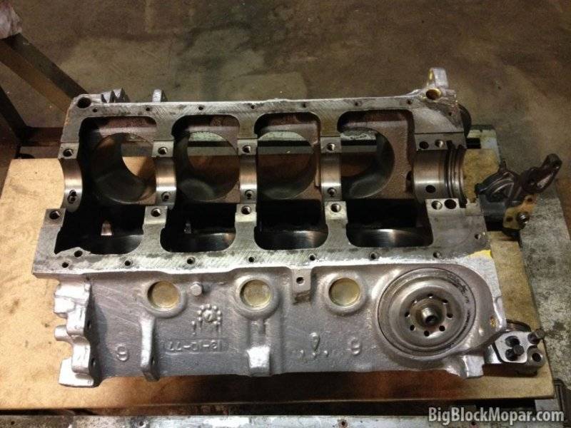

At the oil pan rail, behind the motor mount the first freeze plug but ahead of the middle freeze plug...
