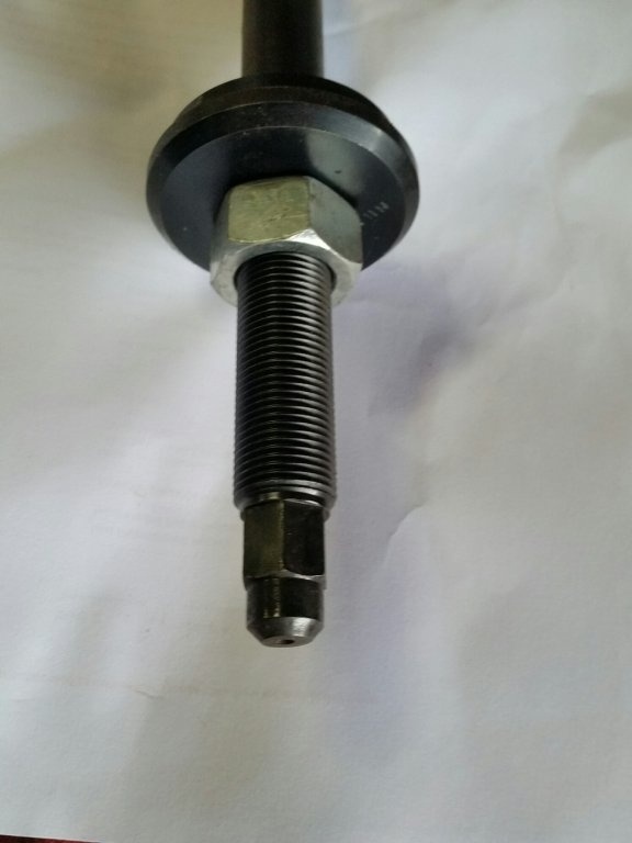

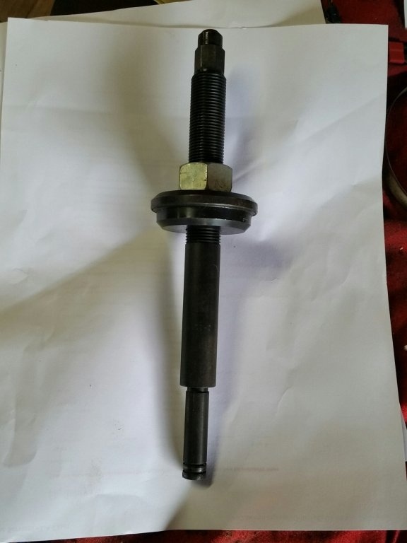

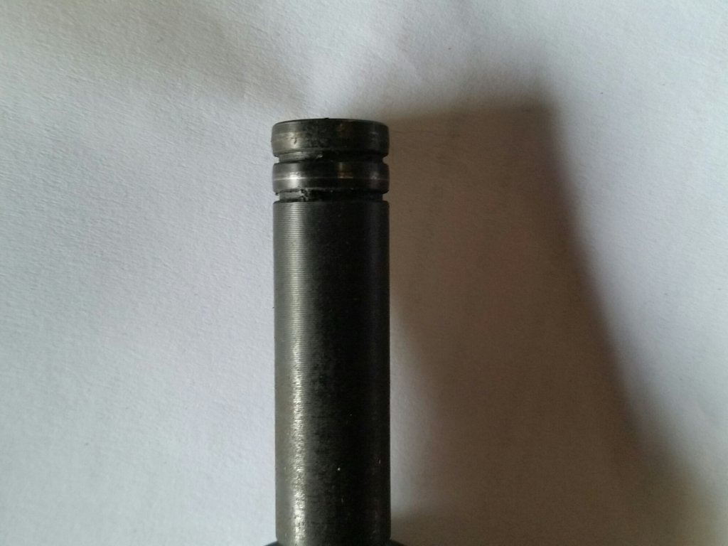

heres some pix of the factory installation tool. it is designed to have the new bushing slid onto the end of the tool, and then hammered into the block, as the tool is screwed out of the bushing it also sizes the bushing to give proper clearance for the new shaft.
